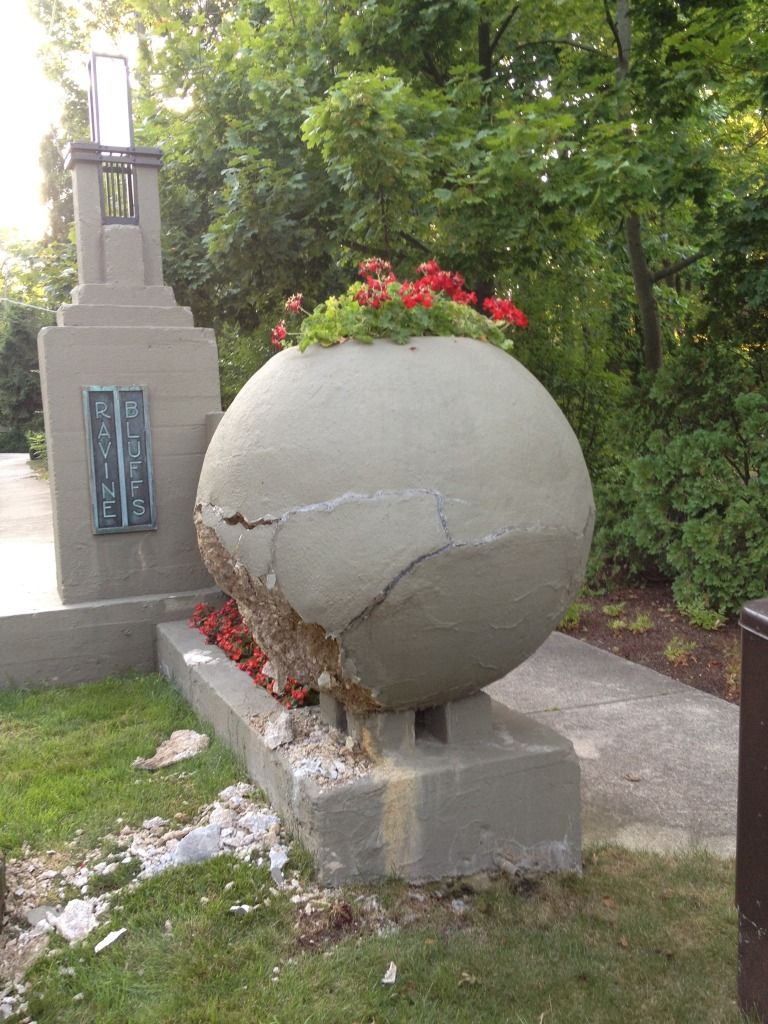

Most of you have seen photos of the sculptures used to mark the entry to the Ravine Bluffs Subdivision. Wright was busy in Japan at the time, so little is known as to the origins of these concrete sculptures. The drawings appear to be in Van Bergen's hand. This past weekend's rains appear to have been the final straw in the valiant effort to keep the planter at Sylvan and Franklin Streets patched together. Note to self - "always waterproof the inside of a concrete planter, and always provide more than adequate drainage" - the freeze/thaw of moisture over time can cause concrete to literally blow apart.

Would it be difficult to replace the sphere and restore the rest?

It can be restored, as Prof. Storrer says that the two on the street corners are "rebuilt" anyway (I don't know if this is equivalent to "replica"). The one in the wooded cul-de-sac is an original.
My photos from two months ago show where the failure is about to occur (bottom photos):

I believe all three markers are original - for a while the street markers lacked their light fixture tops, so those were replicated and reinstalled, however the concrete dates from 1915. He may have been fooled by the buildup of several coats of paint on the concrete.

Thank you for your email. The three planters are owned by the Village of Glencoe . The one at Franklin and Meadow the Village has a maintenance easement for the portion that is not located on public property. They have been maintained by the Village over the past 30 years. The missing metal light fixtures (not operable) on all three monuments were donated by a resident about 10 years ago using plans I had prepared. The monument you noted at the corner of Franklin and Sylvan had been patched over a period of years by the Village. Several large chunks of concrete, about 20% of the bottom half of the round ball portion of the monument fell off about two weeks ago. The Village will be removing this debris. It is anticipated that the repouring of concrete for the bottom portion of the “ball” will require funds from our Village’s next year municipal budget and/or from private contributions. Thank you for your interest. Please feel free to forward this email to all those who may be interested. We anticipate obtaining a projected budget cost in the near future.

The Glencoe Historical Society will be accepting donations (501c3) for the restoration of ALL 3 of the Ravine Bluffs Markers, though the planter at Sylvan and Franklin is the most pressing project. The restoration cost of this marker is $16,000 and includes stripping of paint, installation of drains, concrete repair and reactivation of the light fixture.

John Houde and the Village of Glencoe should be very proud of their efforts to maintain the planters. He understood the problem and tried to slow the deterioration as best he could. Painting the markers also served to protect the concrete from the effects of weather. Unfortunately, you can only leave art out in the rain for a limited amount of time before it needs work.
