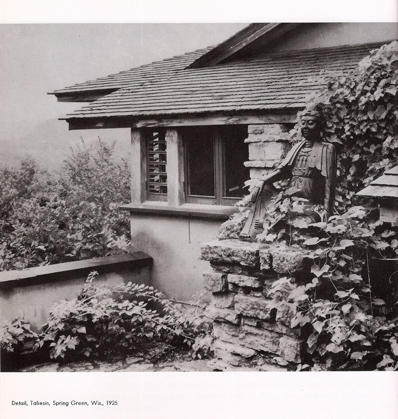

A photograph presented by Wright in his "An American Architecture" (1955).
There just isn't anything "modern" here at all, is there. . .
