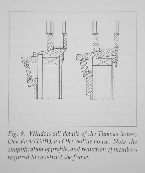

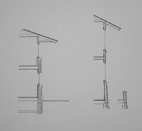

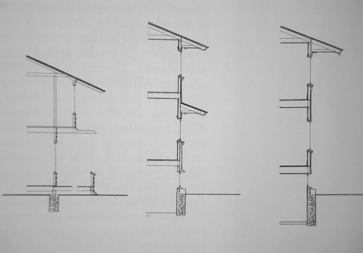

Here are some illustrations from an article (28 pp) published in Modulus 22, the Architectural Review at the University of Virginia (1993) by Kenneth Martin Kao. The piece is titled "Frank Lloyd Wright: Experiments in the Art of Building"; it discusses technical innovations in Wright's practice during the Prairie period.

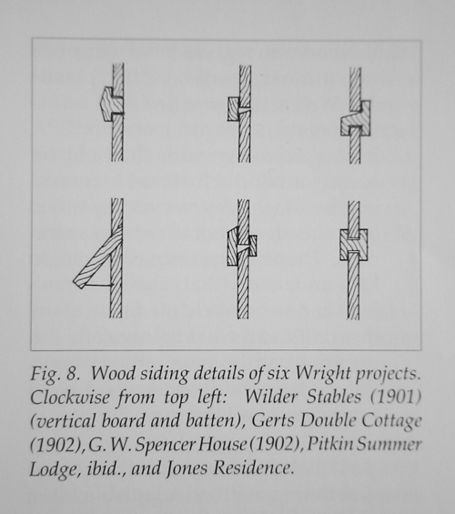

"Comparative wall sections of the E H Pitkin Summer Lodge, Sapper Island, Canada (1900); F B Henderson Residence, Elmhurst, Illinois (1901); Ward Willits House; Arthur Heurtley Residence, Oak Park Illinois (1902); and Frederick B Jones Residence, Lake Delavan, Wisconsin (1901)."
American System Built Houses window detail
Mr Kao, a practicing architect, is a graduate of U Penn, Harvard, and the Lehrstuhl fur Architektur und Konstruktion at the Swiss Federal Institute of Technology (ETH); his dissertation "focussed on the role of technology and experimentation in the work of Frank Lloyd Wright."

Thank you for the information. The batten strip details are somewhat suspect. The board and batten system must stop water travelling horizontally between members, therefore the the board and batten must interlock. Also, the system must account for wood shrinkage and building settlement. The back side of any any board and batten system must be flush because it is applied on top of 1 x 6 horizontal sheathing. The 1901 Davenport board and batten system had these features and they worked exceedingly well for 106 years. I will post a drawing from Davenport on Monday when I get to the office.
Also, the gutters are not shown in the wall sections which are generally concealed.

Indeed, that is curious about the batten wall sections.
What is it that is "generally concealed" ? I think Wright might have preferred chain rain leads over conventional downspouts -- just as auto designers of the 30's drew their fenders as if no bumpers would be defacing them. . .?

SDR: You are correct to question that statement. I checked in my trusty 12 volume FLW Monograph. Most generally had applied gutters. Some had no gutters. A few had concealed gutters.

It's a little hard to decipher the caption of figure 8., above, as there are six illustrations and apparently only five buildings cited -- but if I were building I would be tempted to try a version of the lower left example -- perhaps with a less aggressive batten ? ( You gotta love the sheet-metal closure/support piece indicated.) All pieces could be re-ripped/milled to the same angle, and the drainage/water penetration issue seems well addressed.
How about the metal coping added to the top window trim in the ASBH detail !? The man was mad. . .but you have to admire the relentless drive to conceive and to try everything -- sort of like Mother Nature ?

Look at the headers above the windows in the wall sections. Basically vertical double 2 x headers as one would expect today, are missing. That is what we found on Davenport. In The Details of Modern Architecture, Vol. 1 by Edward Ford, a superb book about the technology of modern architecture, has exterior wall details of the 1902 Ward Willits House. If those details in that book are accurate, a critical difference exists between the exterior wall detailing on the 1902 Willits and the 1901 Davenport House. On Davenport the ribbon windows are just big slices out of a balloon frame with no stud continuity at the windows and no header other than a horizontal 2 x 4. On Ward Willits, the studs actually run continuous through the window mullions. Thus at the window mullions the stud would run continuous from the foundation wall through the window mullions up to the roof framing. This was an enormous improvement over Davenport. On Davenport at three ribbon window locations we had to cut in a single 2 x 12 header to address this. If Ward Willits was designed on a grid, it probably grew out of this technical requirement.
Another key difference between Ward Willits and Davenport is that the top chord of the truss is a 2 x 6. On Davenport this is a 2 x 4. This was critical improvement for the overhangs because the top chord of the truss extended out for the broad overhang framing. FLW's house technology evolved with the development of new design ideas, Unfortunately along the way there were some technical failures with many successes. FLW was a technical optimist.
