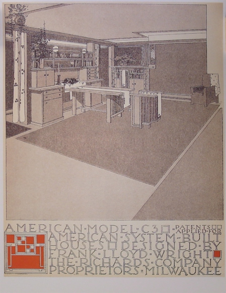

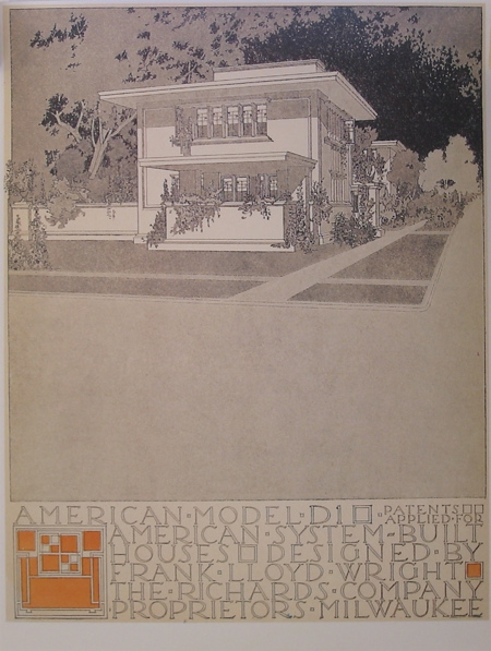

guanche -- where did you find the model, posted above ? Such work is rare, and gives a good look at one of the ASB types. The exterior photo is helpful
in identifying and further understanding the design.

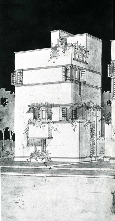

I will publish everything I have on these designs, which may (or may not) answer questions about them. There seems to be very little on the bungalow type house. . .
First, can anyone enlighten us on this town house ? Wright published it
in "A Testament" (1956; p 113) as "1912. Project, Small Town House":

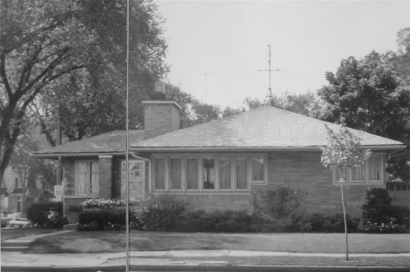

A close look reveals that these are two different houses. Note light-colored stone under second tall window from left, in first photo, absent
in second; also (more obviously), walk is in different location.
The color photo (by Simon Clay) is identified as "Arthur L Richards Bungalow, 1835 South Layton St, Milwaukee." There is also an "ALR
Small House" at 2714 W Burnham St in the same city, in the same block as the ALR Duplex Apartments.

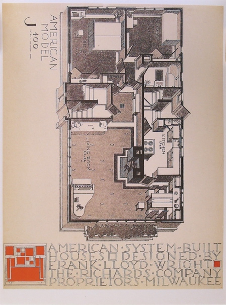

The last one of these is certainly a "flopped" version of the house modeled above.
Compare to below, and to Model J, above.

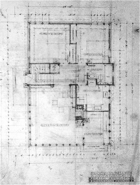

SDR, I think the two bungalow photos are of the same house, just taken at different times with some alterations made. Look, for instance, at the two chimneys; they look identical. As far as I know, this is the only bungalow with faux stone facing. The drawing of the townhouse is one of the Monolith Homes of the early 20s, and is usually credited to Schindler. Though the plan of this house has never been published, if you impose the two-foot square grid that was used on these houses, you will find it hard to find any floor space left over once the stairway is accounted for. There is one Monolith plan published that has a very rigidly symettrical plan obviously by RMS. McCoy says all of them were designed by him, and I tend to agree. The 1912 date is harder to reconcile. If that is indeed an accurate date (FLW often dated his work years after the fact) then I suspect this may not have been a part of Monolith, but I think the date is wrong. The first interior perspective is the bungalow living/dining room. The house next to that is the model for the late Gary, IN house. American Model B1 plan is the cottage, the following plan is the basic bungalow. The last plan is not the cottage that is modeled, nor any of the others pictured.

Thanks, Roderick. In what ways is the model not identical to the plans labeled B1 (one each in my two posts, the first "colored in") -- if you account
for the fact that the model is a mirror image (I call it flopped) of the plans ? Every partition and window is there, as well as the front terrace with its
dropped full-length planter. . .as far as I can see.
I looked closely at the stonework of the two images of the bungalow(s), and think I see significant differences. What do you make of the fact that the
two images show a front walk coming to the street differently -- one to the front, the other off to the left ?
Posts: 8032
PostPosted: Sun Jul 26, 2009 8:47 pm    Post subject: Reply with quote
A very close look at the chimneys of the two houses shows the stone pattern to be identical -- so Roderick is correct that these are the same house.
This house (the Bungalow) is at the corner of West Burnham and South Layton in Milwaukee. The walkway was apparently moved at some point,
from one alignment to the other. Next door to the west is the ALR Small House, and then come the four Duplex Apartments. Storrer says the stone
veneer was added to the Bungalow in 1956.
The Bungalow shows up in its original form, in the second and third photos on this page:
http://www.wrightinmilwaukee.com/LinkClick.aspx?fileticket=fgZmbWeObX0%3D&tabid=69&mid=457
It also appears at the far right in the strip drawing at the bottom of the page.
And, it is seen here: http://www.wrightinmilwaukee.com/TheHomes/ModelC31835SouthLaytonBoulavard/tabid/70/Default.aspx

SDR, I think I was misreading your comment. The plan I referred to is the fuzzy one right under "The last one of the is certainly a ...." which is not represented in any other image. But it would appear on second reading you were referring to American Model B1, which is indeed a flopped version of the built cottage.
